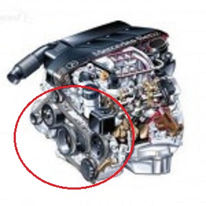

By the way may I know how does the compressor look like?
Bro, the kompressor uses a belt drive that is attached directly to the crankshaft of the car engine. The crankshaft is particularly designed to covert the linear motion of piston into a significant rotational energy that is again further converted to electrical or mechanical needs that the car requires. Thus, the superchargers are powered by the belt attached to the crankshaft, converting the rotational energy to the energy that is needed for controlling the forced induction in the Mercedes kompressor.
