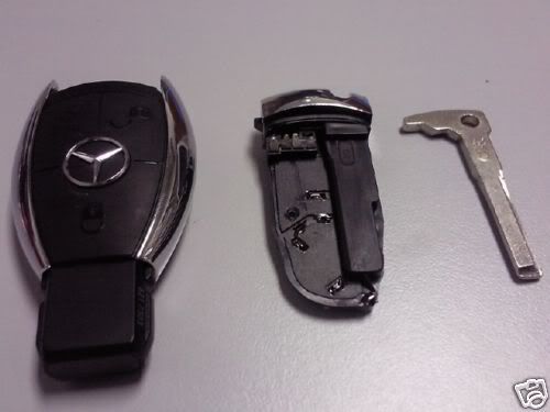

Yup! got it from Taiwan. OEM chrome type FOB shell. here's the picture:
PM me f u wanna view ya!

Trex81 wrote:
Nice... Can change W203 key to this bro? How much it cost and gotta reprogramme the key to get it to work?
Oh! i changed my W203 FOB to this chrome type. But its not easy. managed to get someone who make the PC board with the same skemetic with the chrome type PCB, then desolder the 2 EEPROM chips( AMS & NEC ) from my W203 FOB to this new PC board. Finally to this new chrome shell. But its definitely worth it! Total cost about $300.

Yup! U r right! FOr W203, the FOB will always be the old type. I have checked with C&C, the cost of a new(W203 model) FOB is about $800. So, no point paying that amt for still a old model FOB.

For old black W203 FOB empty shell, the cost is actually less than $100. I have also checked with Soxxi but they only have the old type(Black). Unless, u wanna change to the same old type, if not, u need to change the PCB as the old PCB cannot fit onto the new chrome PCB. anw, quite like the feel of the chrome type, so i think the price is still worth it for modifing the PCB & the empty shell.

oh, really? hmm...din noe there r W203 models come with the chrome type FOB. anw, it will not be any economical solution lo...as the chrome type empty shell( OEM ) already cost about $150( new original will cost around USD300+), then u need to change the PCB to the chrome type PCB in order to fit into the chrome type...

What's the reason for the old W203 pcb not able to fit into the chrome type? Is it the size or the space for certain component? I am thinking in the line of cutting more space if this is the problem.

the W203 PCB is way much bigger than the W204 chrome type. So, there is no way u can cut the shell or PCB to fit onto the chrome shell(u can refer to my pic on page 1). The only way is to make another PCB with the same skemetic and size as the chrome type, switch the EEPROM over. If any bro have a more economical way, do let me know ya.
