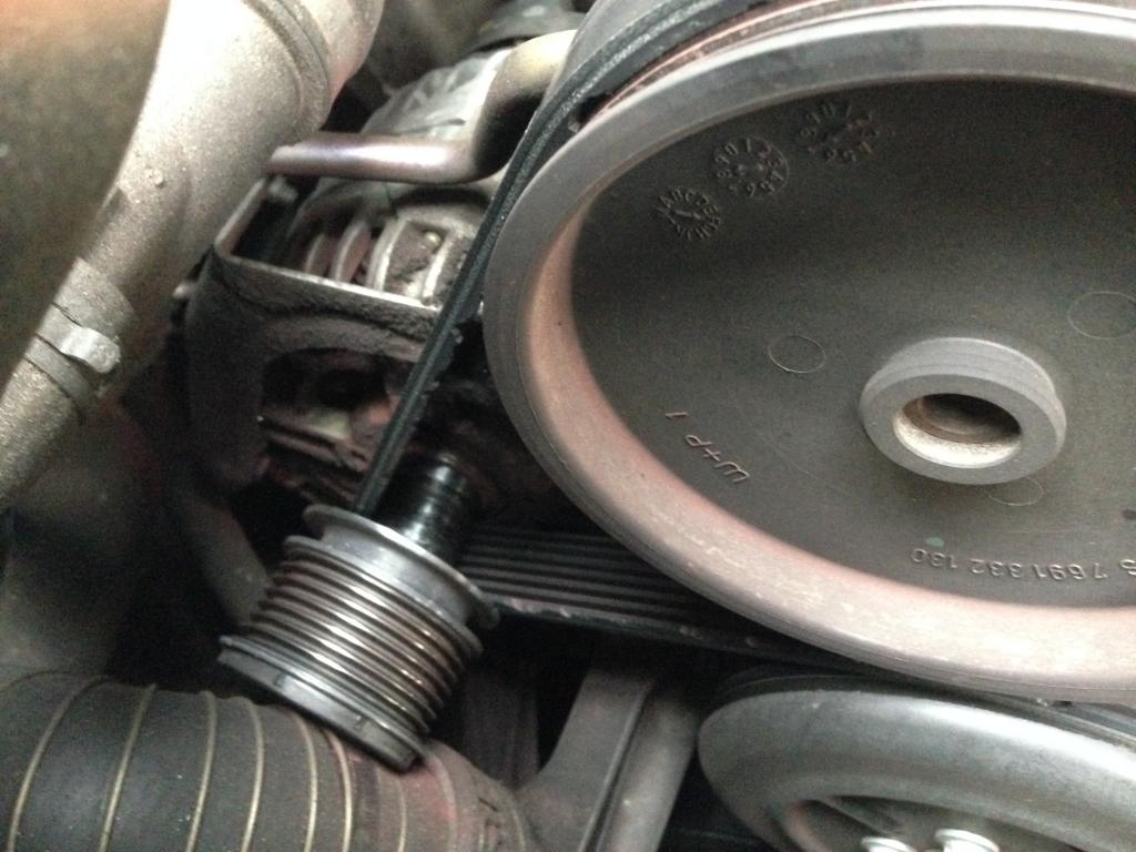

like to hijack this topic to include some information on alternator clutch pulley issue that i encountered:
pulley slipped off belt after prolong high pitch noise
by the time my car got to the workshop, i was informed that i need to replaced the entire alternator instead of the alternator pulley. total damage is $760 inclusive of the fan-belt. if only i had visit the workshop earlier, i may have the option to change the pulley only. Ebay is only selling for a small amount.
