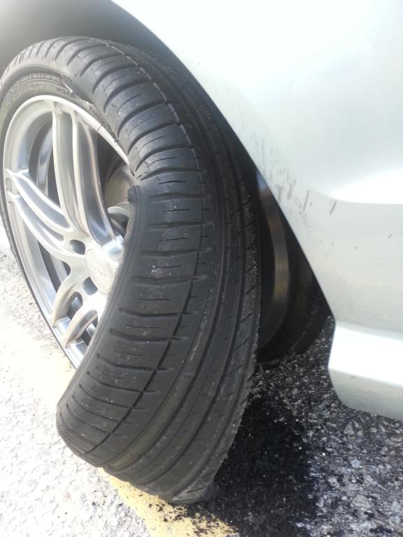

The tyre really looks new....care to share what tyre u used?
Tyres look worn on the inner threads. Could be a case of under inflation or leak. Based on the height of the suspension, it can't be due to negative camber. Perhaps the rim itself might have developed a leak since you have gone through so many tyres.

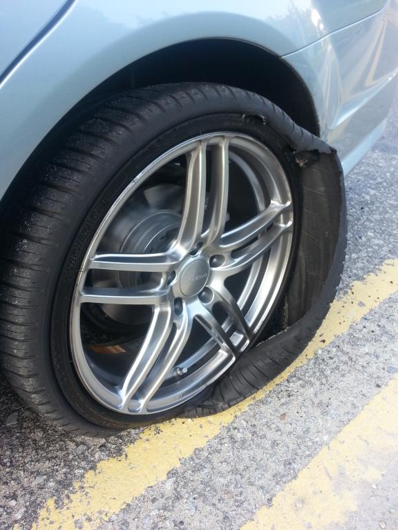

not sure if its the picture but the tire looks weird as if the rubber is sort of separate from the tire wall. seems like the hole is on the wall.
perhaps u can check the week/year stamp on the side of the tire to determine when it came out of the factory. like 5212 is 52nd week of 2012 to confirm freshness
wow... 13 tyres in 1 week? And how did you manage to burst your tyre so badly? A case of over inflation?
Rmb to get your rims checked as they might be dented/cracked when they hit the road

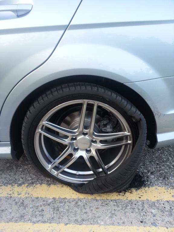

I was on stock pzero for the 1st 4 tyres then nxt day went leong seng to change new rims n tyres to csc5... Then after tat went hm feels tat 17" like very small so nxt day went bk to change 18" n new set of ps3 tyres.. Haha... So total i used 12 tyres plus the spare tyre makes 13 lo...
I kena a big nail at seletar west link tats y the tyre msg prompt came on but bef i can go check the tyre bursted due to the heat fr wat i was told by daniel of leong seng..
They checked my rim n said it is ok.. Not even a scratch.. Lucky it is prodrive he said very durable
